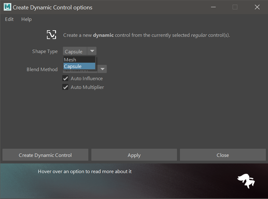

Default Capsule
Ragdoll now defaults to the newer Capsule shape type for dynamic controls. It's faster and applies more generally to most rigs; even those that do have NURBS curves wrapping around the underlying character geometry.

You can change the shape type after creation, and modify the default value in the options dialog.

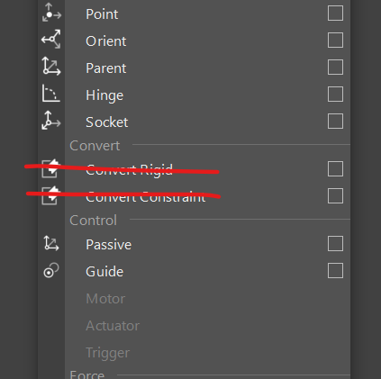

Convert and Restore
I've merge the Convert Rigid and Convert Constraint buttons into the rigid and constraint creation buttons.
