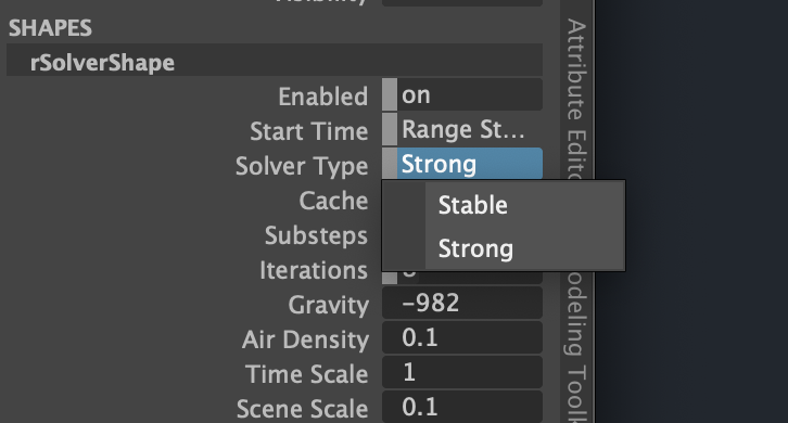

solverType Differences
Type Description
Strong Better for characters, it makes the Rotate Stiffness stronger; more capable of matching the animated pose. It can become unstable if there are too many loose objects in the scene.
Stable Better for many independent objects, like a destruction scene.
You can find solverType under the Channel Box and the Attribute Editor.
