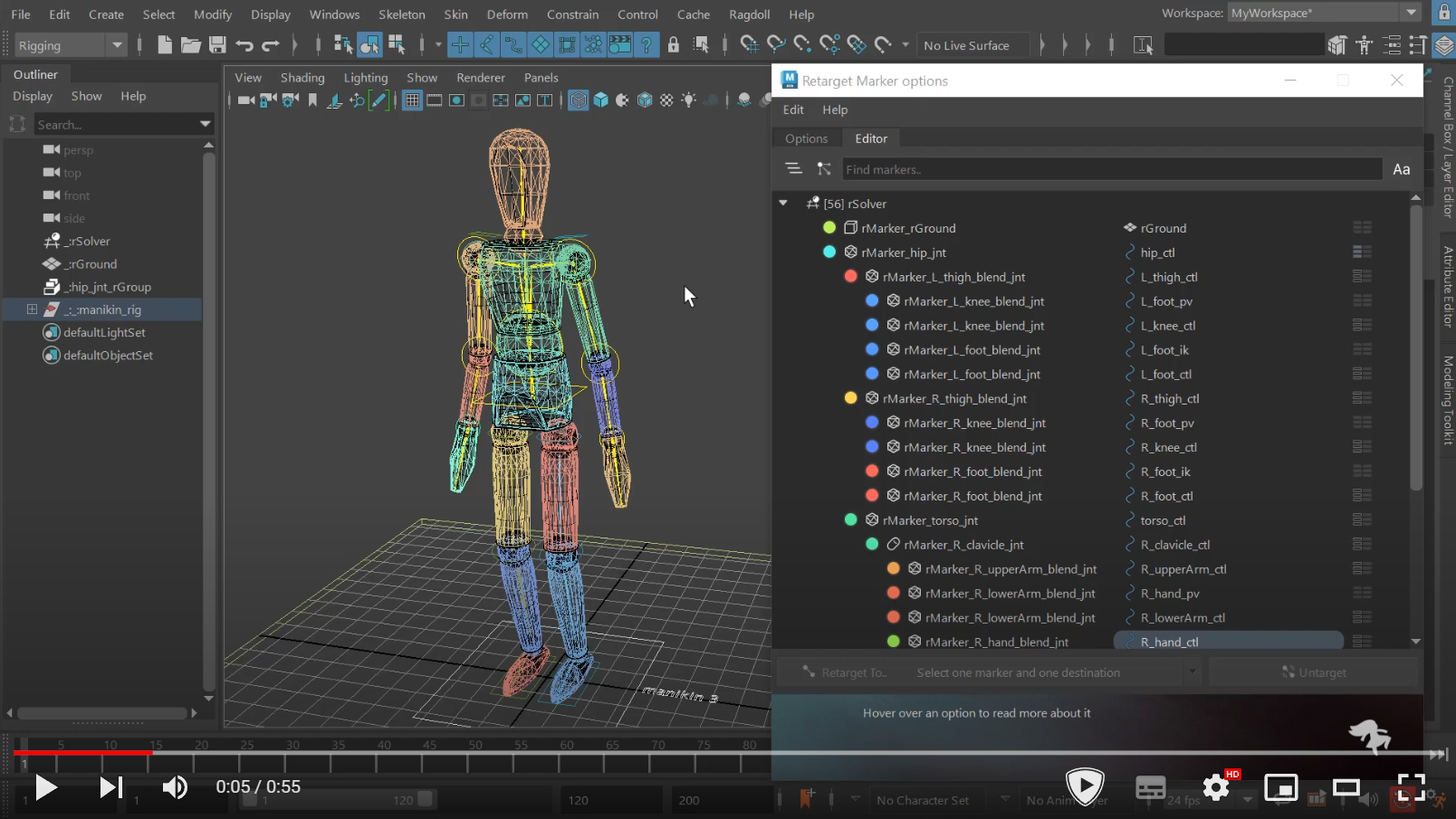

Retargeting
Assign to joints, record to controls.
Retarget
You can visually see where keyframes go upon running Record Simulation.

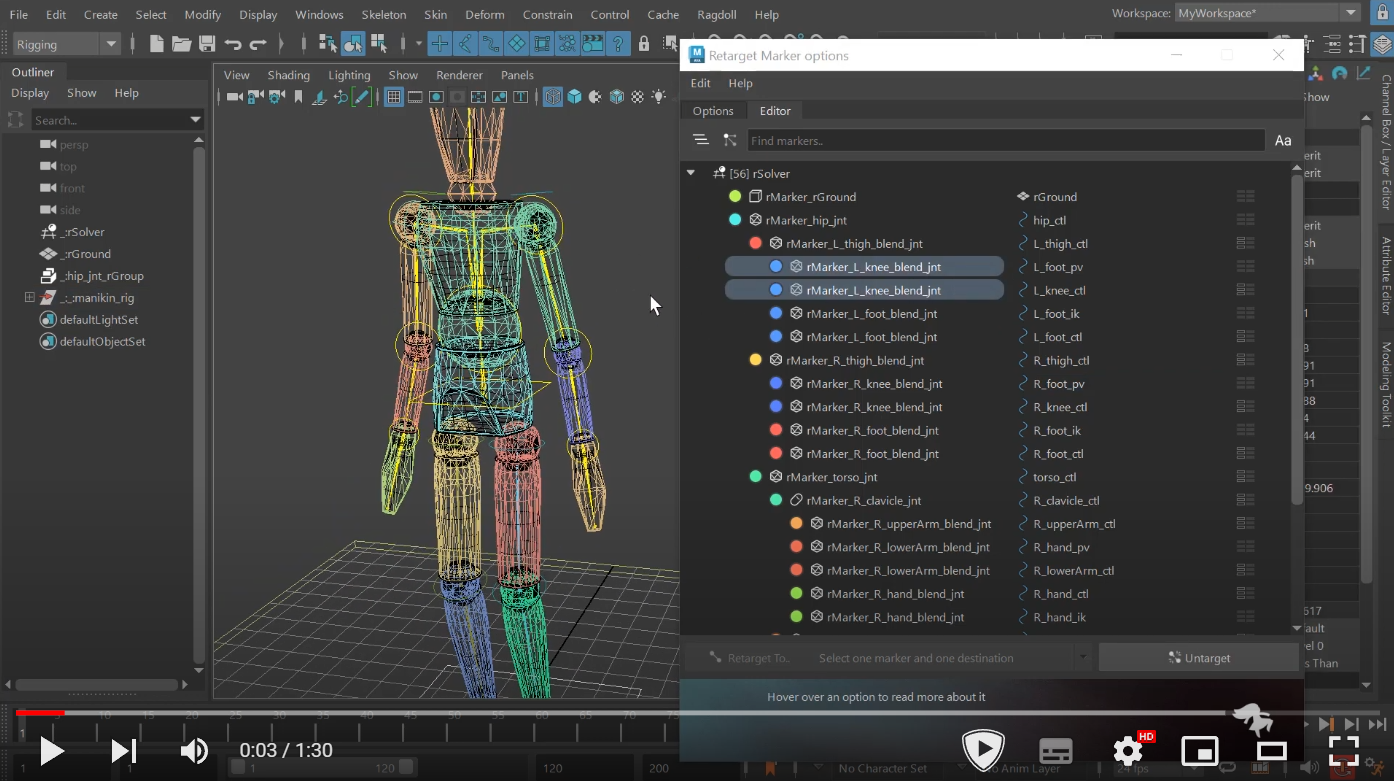

Warnings
The UI can help you spot problems with recording, before recording happens.
In this case, some of our markers are retargeted onto joints that are driven by some other object. If we were to attempt to record these, it's unclear what the result should be.
  1. Should they retain their connection to the thing already driving them?
  2. Or should they abandon that, and become keyframed by the simulation?
Neither of these are a great pick, since we don't want to break the rig, but we also want our simulation to go somewhere.

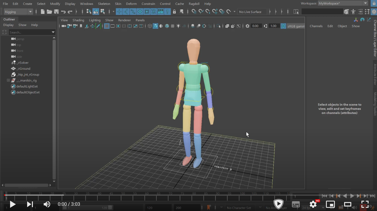

Workflow
Once you've assigned your markers, grab a clean slate and gain complete control over where animation is to be recorded.

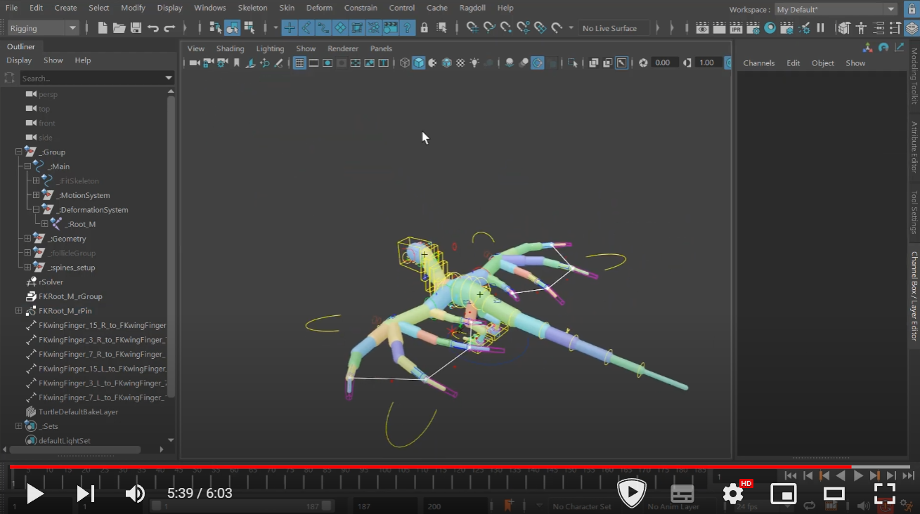

Complete Demo
And finally, here's a longer-form example of a full setup of the Truong Dragon that we did a livestream on a while back.

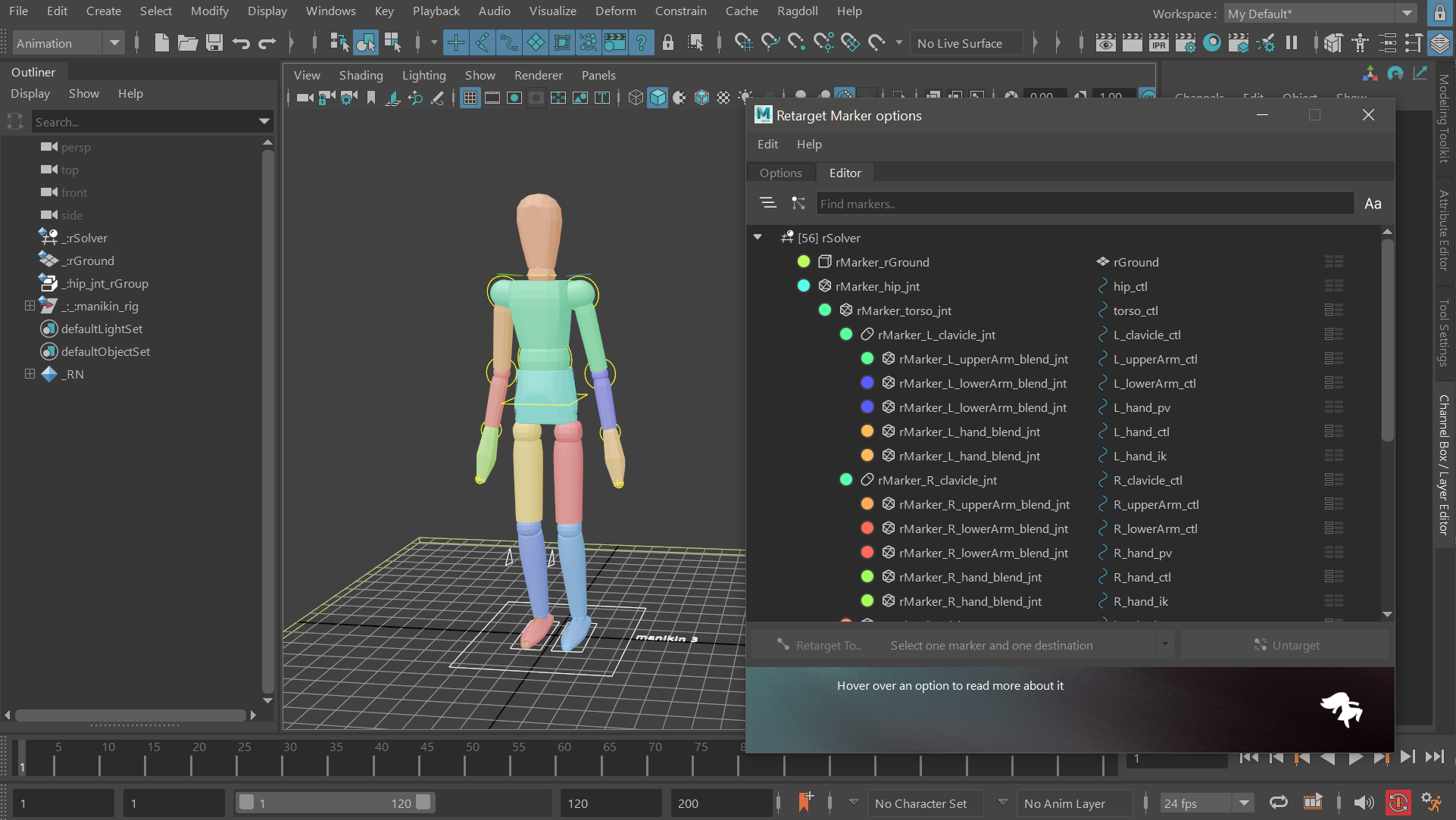

Reassign
The opposite of Retarget.
Rather than assigning to joints and retargeting to IK controls, we assign to IK controls and reassign to joints. Same coin, different side; which one do you prefer?
