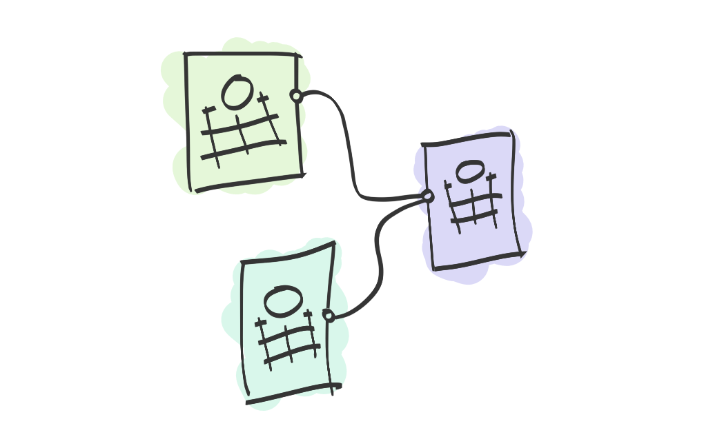

Let me introduce Solver Linking, a lightweight and non-destructive alternative.
Linking
This fellow is referenced twice, and get their solvers linked together.

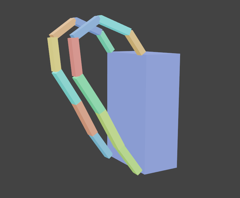

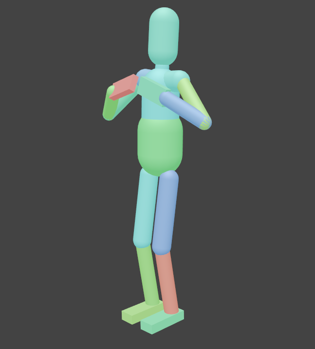

Here are 2 assets, a manikin and a backpack.
Manikin Backback
image image
The backback and manikin has been combined into one, which is then referenced twice into the final scene for a total of 4 unique solvers.

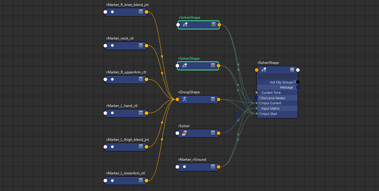

Non-destructively link solvers
Notice the hierarchy of solvers formed here, enabling you to build complex solvers out of many small solvers.
Non-destructively unlinking too
Likewise, safely deconstruct a network of solvers by just removing the connection.
Technically, a solver is added to another solver in the same manner a marker, group and constraint is added. One big happy family.
