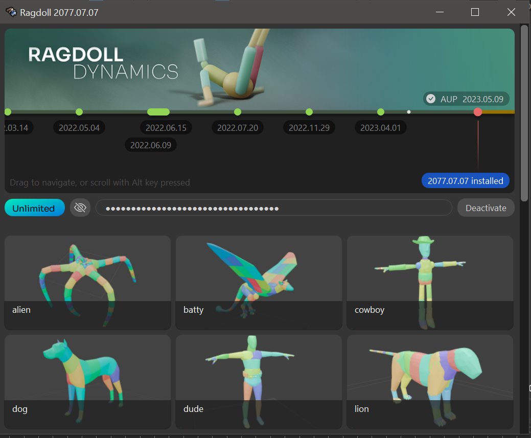

On first launch, Ragdoll will try and connect to the Ragdoll Licence Server and register your trial version. This version is node-locked to the particular machine you are on.
Once you've acquired a product key, you can either:
  1. Click the Ragdoll menu item (bottom)
  2. Enter your product key
  3. Click Activate

For node-locked licences, you can hit the Deactivate button (which is same as the Activate button once you've activated) and the serial may be used to activate another machine.
