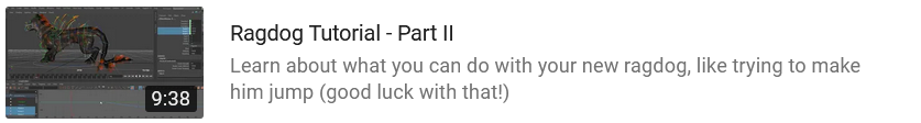

Ragdog Tutorial
That's no typo, this is a Ragdoll-dog! :D Learn about how to achieve the above simulation in this 2-part series on using Dynamic Control.
