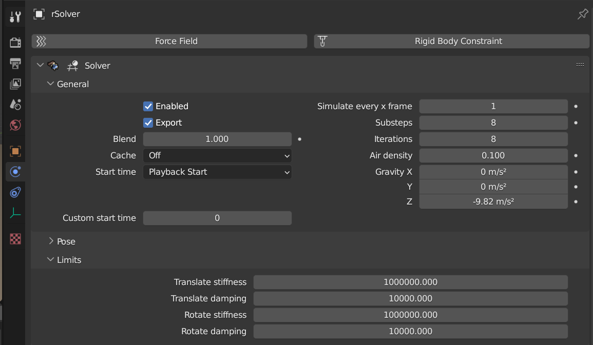

Global Damping
This, and other stiffness and damping-related attributes, can be controlled globally - for every limit in your scene - via the rSolver node.
