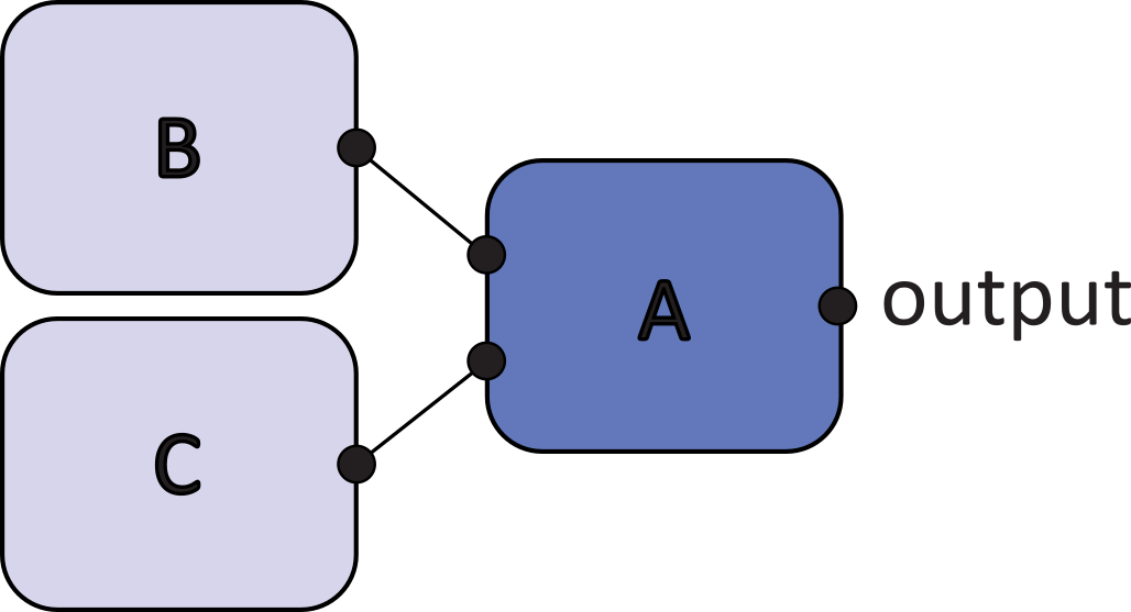

The basic description of the scene is the Dependency Graph (DG), consisting of DG nodes and connections. Nodes can have multiple attributes, and instances of these attributes on a specific node are called plugs. The DG connections are at the plug level, that is, two nodes can be connected to one another multiple ways through different plugs. Generally speaking, these connections represent data flow through the nodes as they evaluate. The following image shows an example DG:
The dotted arrows inside the nodes represent an implicit computation dependency between an output attribute (on the right of the node) and the input attributes (on the left) being read to compute the result stored in the output.

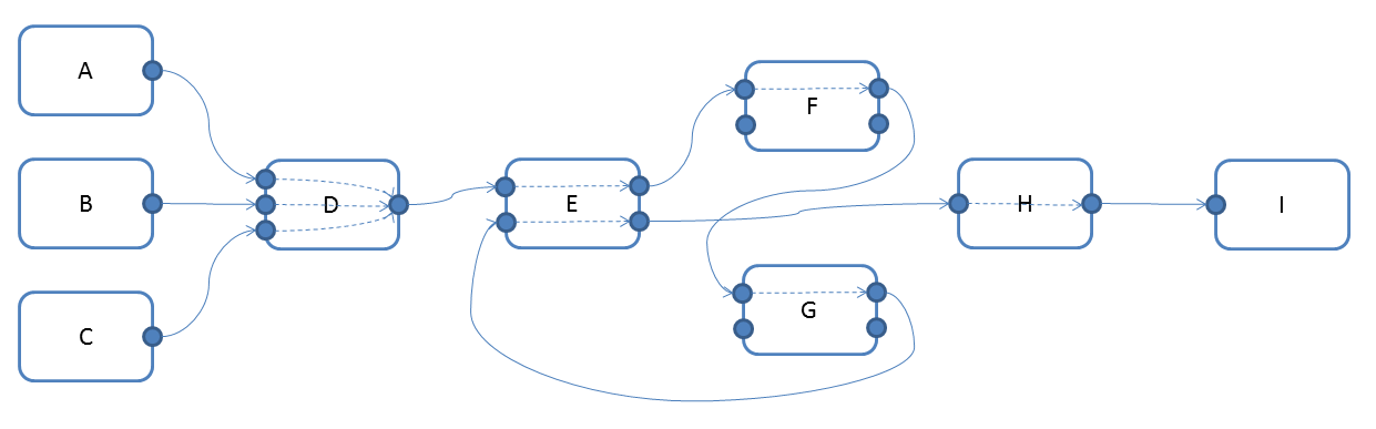

To have tighter control over evaluation, Maya now uses a Forward Evaluation model to enable concurrent evaluation of multiple nodes. The general idea is simple: if all a node’s dependencies have been evaluated before we evaluate the given node, pull evaluation will not be triggered when accessing evaluated node data, so evaluation remains contained in the node and is easier to run concurrently.
All data dependencies between the nodes must be known to apply this evaluation model, and this information is captured in the Evaluation Graph (EG), containing Evaluation Nodes. The EM uses dirty propagation to capture dependency information between the nodes, as well as which attributes are animated. EG connections represent node-level dependencies; destination nodes employ data from source nodes to correctly evaluate the scene. One important distinction between the DG and the EG is that the former uses plug-level connections, while the latter uses node-level connections. For example, the previous DG would create the following EG:

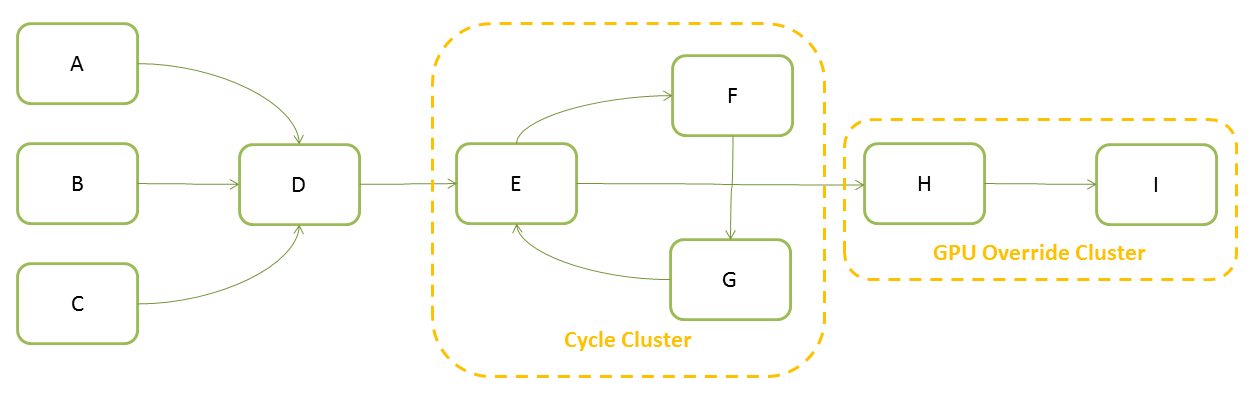

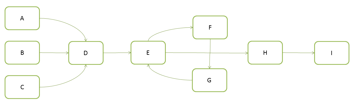

While the EG holds the dependency information, it is not ready to be evaluated concurrently as-is. The EM must first create units of work that can be scheduled, that is, tasks. The main types of task created are:
  • Individual Nodes: in the simplest case, an evaluation node can be computed directly. The task therefore consists of evaluating all of its animated attributes.
  • Cycle Clusters: depending on the scene, the EG may contain circular node-level dependencies. If this is the case, the EM creates clusters that group together nodes in the same cycle. At scene evaluation time, nodes in cycle clusters are evaluated serially before continuing with other parallel parts of the EG, hence the evaluation of a cycle cluster consisting of a single task. While node-level cycles are perfectly legal, creating scenes with attribute-level cycles should be avoided as this is unsupported and leads to unspecified behavior.
  • Custom Evaluator Clusters: the EM supports the concept of custom evaluators to override evaluation of sub-section of the EG. One example of this is the GPU override, which uses your graphics card’s graphics processing unit (GPU) to accelerate deformations. The custom evaluators will create clusters for nodes for which they take responsibility, and the EM creates a task for each of these clusters. At scene evaluation time, control is passed to the specific custom evaluator when the task is up to be executed.
This step, called partitioning, is where the EM creates the individual pieces of work that will have to be executed. Each of these tasks will map to a Scheduling Node in the Scheduling Graph (SG), where connections represent dependencies between the tasks:
The SG is an acyclic graph, otherwise it would be impossible to schedule nodes in a cycle since there would be no starting point for which all dependencies could be evaluated. In addition to the dependencies that come directly from the EG, the SG can have additional scheduling constraints to prevent concurrent evaluation of subsets of nodes (see Scheduling Types for details).

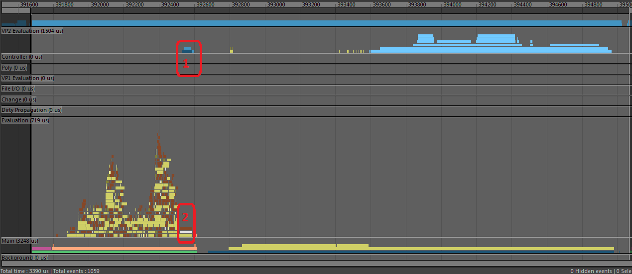

You can use the controller command to identify objects that are used as animation sources in your scene. If the Include controllers in evaluation graph option is set (see Windows > Settings/Preferences > Preferences, then Settings > Animation), the objects marked as controllers will automatically be added to the evaluation graph even if they are not animated yet. This allows Parallel evaluation for manipulation even if they have not yet been keyed.

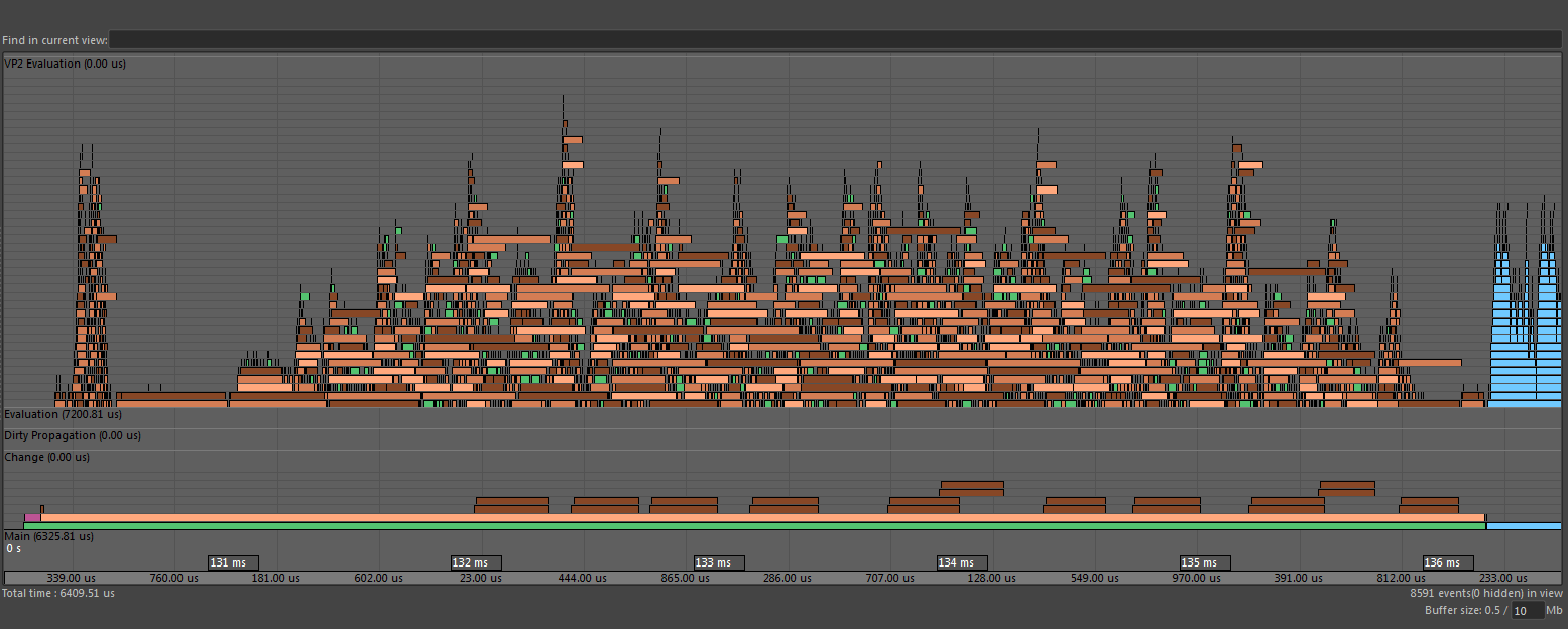

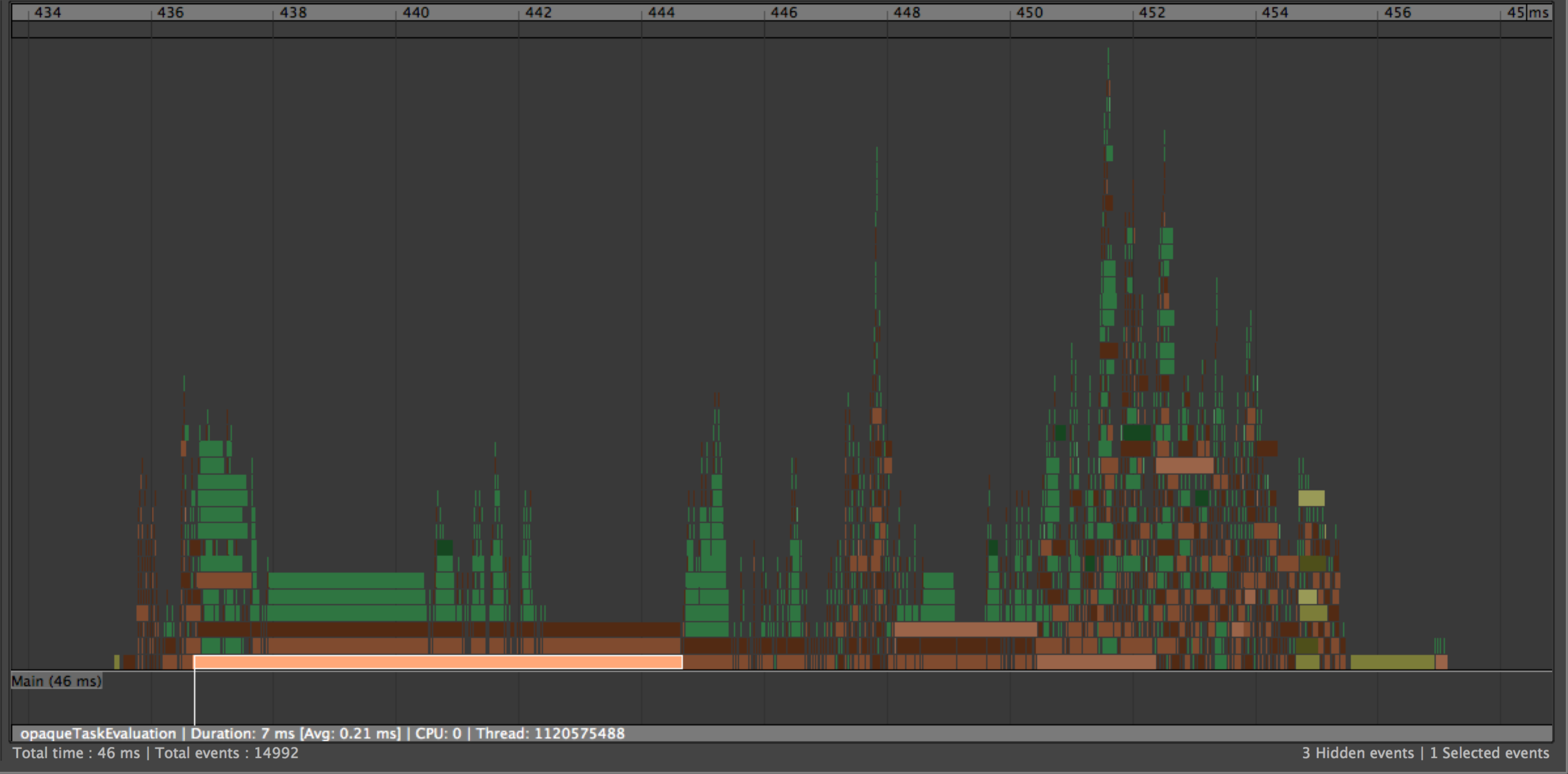

DG Evaluation
In this profile of DG Evaluation we can see several types of event.
  1. Pink and purple Dirty Propagation events in the Dirty Propagation category.
  2. Dark green Pull Evaluation events in the Evaluation category.
  3. Blue VP2 Pull Translation and light blue VP2 Rendering in the VP2 Evaluation category.
  4. Yellow events in the VP2 Evaluation category show time VP2 spent waiting for data from Dependency Graph nodes.
A significant fraction of each frame is spent on Dirty Propagation, a problem which is alleviated by Evaluation Manager.

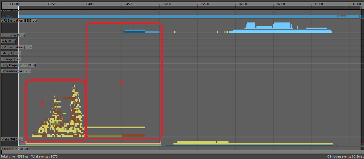

EM Parallel Evaluation
In this profile of EM Parallel Evaluation we can see all the purple and pink dirty propagation is gone.
  1. Peach, tan and brown EM Parallel Evaluation events of the FK rig colored. The high stack of events represents some evaluation occurring in parallel (use thread view to better understand parallelism).
  2. Tan and brown EM Parallel Evaluation events while Maya evaluates the skin cluster to compute the deformed mesh. These events occur serially because the Dependency Graph has no parallelism.
  3. Dark blue and blue VP2 Direct Update events translate data into a VP2 render-able format.
  4. Yellow in the Main category and light blue in the VP2 Evaluation category are VP2 Rendering events.
In this profile we see much less time spent on Vp2SceneRender (4). This occurs because time spent reading data from dependency nodes has been moved from rendering to EM Parallel Evaluation (1). DG evaluation uses a data pull model, while EM Evaluation uses a data push model. Additionally, some geometry translation (2), is also moved from rendering to evaluation. We call geometry translation during evaluation “VP2 Direct Update”. A significant portion of each frame is spent deforming and translating the geometry data, a problem which is alleviated by GPU Override.

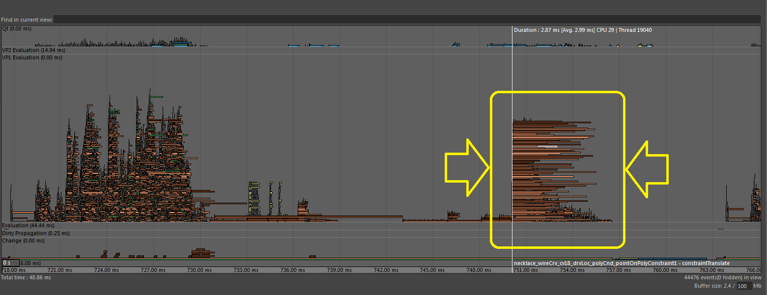

EM Parallel Evaluation with GPU Override
In this profile of EM Parallel Evaluation we can see one major new difference from the previous profile of EM Parallel Evaluation.
  1. Light and dark yellow GPU Override events have replaced the long serial central part of the EM Parallel Evaluation profile (2 & 3 from EM Parallel Evaluation). The GPU Override events represent the time taken on the CPU to marshal data and launch the GPU computation.
  2. Peach, tan and brown EM Parallel Evaluation events here have roughly the same duration as EM Parallel Evaluation even though the relative size of the rig evaluation events with GPU Override is larger. This is because the scale of this profile is different from the scale of the previous profile. In the profile of EM Parallel Evaluation with GPU Override the total time displayed is about 5ms. In the previous profile of EM Parallel Evaluation the total time displayed is about 12ms.
  3. Light blue VP2 Render events have experienced a similar relative stretching (2).
EM Evaluation Cached Playback
In this profile of EM Evaluation Cached Playback we can see several new types of event.
  1. Yellow Restore Cache events recording the time taken to update each FK rig node which has cached data. There are also brown VP2 Direct Update events used to track update of the VP2 representation of the data.
  2. Yellow Restore Cache event for the deformed mesh. This represents the time taken to restore the data into the Maya node, and to translate the data into VP2 for drawing using VP2 Direct Update.
EM VP2 Hardware Cached Playback
  1. Dark blue VP2 Hardware Cache Restore events have replaced the long serial Cache Restore event (2 from EM Evaluation Cached Playback). Restoring the VP2 Hardware Cache is much faster because the data is already in in the render-able format and stored on the GPU.
  2. Gray Cache Skipped event signaling data in the dependency node is not updated.

Lock Contention. When many threads try to access a shared resource you may experience Lock Contention, due to lock management overhead. One clue that this may be happening is that evaluation takes roughly the same duration regardless of which evaluation mode you use. This occurs since threads cannot proceed until other threads are finished using the shared resource.
Here the Profiler shows many separate identical tasks that start at nearly the same time on different threads, each finishing at different times. This type of profile offers a clue that there might be some shared resource that many threads need to access simultaneously.
Below is another image showing a similar problem.
In this case, since several threads were executing Python code, they all had to wait for the Global Interpreter Lock (GIL) to become available. Bottlenecks and performance loses caused by contention issues may be more noticeable when there is a high concurrency level, such as when your computer has many cores.
If you encounter contention issues, try to fix the code in question. For the above example, changing node scheduling converted the above profile to the following one, providing a nice performance gain. For this reason, Python plug-ins are scheduled as Globally Serial by default. As a result, they will be scheduled one after the other and will not block multiple threads waiting for the GIL to become available.

When the main bottleneck in your scene is rendering, we say the scene is render-bound. The following is an illustration of a sample result from the Maya Profiler, zoomed to a single frame measured from a large scene with many animated meshes. Because of the number of objects, different materials, and the amount of geometry, this scene is very costly to render.
![][image6.jpeg]
The attached profile has four main areas:
  • Evaluation (A)
  • GPUOverridePostEval (B)
  • Vp2BuildRenderLists (C)
  • Vp2Draw3dBeautyPass (D)
In this scene, a substantial number of meshes are being evaluated with GPU Override and some profiler blocks appear differently from what they would otherwise.
Evaluation. Area A depicts the time spent computing the state of the Maya scene. In this case, the scene is moderately well-parallelized. The blocks in shades of orange and green represent the software evaluation of DG nodes. The blocks in yellow are the tasks that initiate mesh evaluation via GPU Override. Mesh evaluation on the GPU starts with these yellow blocks and continues concurrently with the other work on the CPU.
An example of a parallel bottleneck in the scene evaluation appears in the gap in the center of the evaluation section. The large group of GPU Override blocks on the right depend on a single portion of the scene and must wait until that is complete.
Area A2 (above area A), depicts blue task blocks that show the work that VP2 does in parallel to the scene evaluation. In this scene, most of the mesh work is handled by GPU Override so it is mostly empty. When evaluating software meshes, this section shows the preparation of geometry buffers for rendering.
GPUOverridePostEval. Area B is where GPU Override finalizes some of its work. The amount of time spent in this block varies with different GPU and driver combinations. At some point there will be a wait for the GPU to complete its evaluation if it is heavily loaded. This time may appear here or it may show as additional time spent in the Vp2BuildRenderLists section.
Vp2BuildRenderLists. Area C. Once the scene has been evaluated, VP2 builds the list of objects to render. Time in this section is typically proportional to the number of objects in the scene.
Vp2PrepareToUpdate. Area C2, very small in this profile. VP2 maintains an internal copy of the world and uses it to determine what to draw in the viewport. When it is time to render the scene, we must ensure that the objects in the VP2 database have been modified to reflect changes in the Maya scene. For example, objects may have become visible or hidden, their position or their topology may have changed, and so on. This is done by VP2 Vp2PrepareToUpdate.
Vp2PrepareToUpdate is slow when there are shape topology, material, or object visibility changes. In this example, Vp2PrepareToUpdate is almost invisible since the scene objects require little extra processing.
Vp2ParallelEvaluationTask is another profiler block that can appear in this area. If time is spent here, then some object evaluation has been deferred from the main evaluation section of the Evaluation Manager (area A) to be evaluated later. Evaluation in this section uses traditional DG evaluation.
Common cases for which Vp2BuildRenderLists or Vp2PrepareToUpdate can be slow during Parallel Evaluation are:
  • Large numbers of rendered objects (as in this example)
  • Mesh topology changes
  • Object types, such as image planes, requiring legacy evaluation before rendering
  • 3rd party plug-ins that trigger API callbacks
Vp2Draw3dBeautyPass. Area D. Once all data has been prepared, it is time to render the scene. This is where the actual OpenGL or DirectX rendering occurs. This area is broken into subsections depending on viewport effects such as depth peeling, transparency mode, and screen space anti-aliasing.
Vp2Draw3dBeautyPass can be slow if your scene:
  • Has Many Objects to Render (as in this example).
  • Uses Transparency. Large numbers of transparent objects can be costly since the default transparency algorithm makes scene consolidation less effective. For very large numbers of transparent objects, setting Transparency Algorithm (in the vp2 settings) to Depth Peeling instead of Object Sorting may be faster. Switching to untextured mode can also bypass this cost
  • Uses Many Materials. In VP2, objects are sorted by material prior to rendering, so having many distinct materials makes this time-consuming.
  • Uses Viewport Effects. Many effects such as SSAO (Screen Space Ambient Occlusion), Depth of Field, Motion Blur, Shadow Maps, or Depth Peeling require additional processing.
Other Considerations. Although the key phases described above apply to all scenes, your scene may have different performance characteristics.

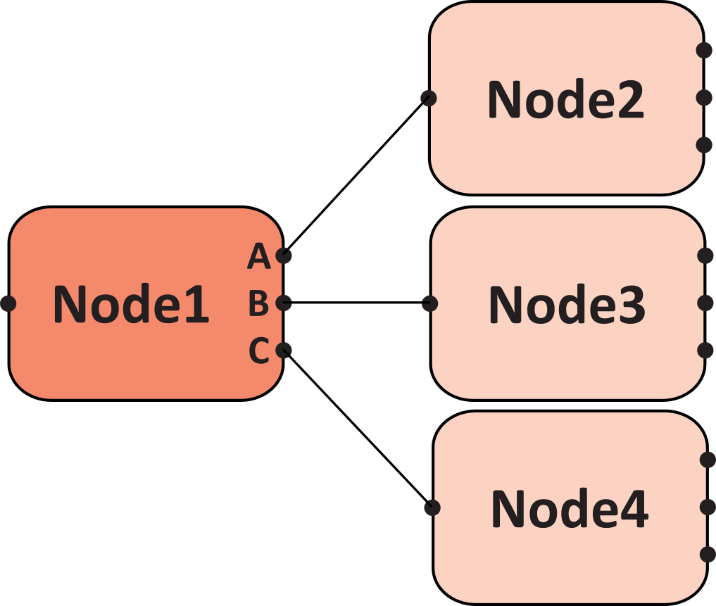

Let’s assume that your scene contains the following three nodes. Because of the dependencies, the evaluation manager must compute the state of nodes B and C prior to calculating the state of A.
Now let’s assume Analysis Mode returns the following report:
Detected missing dependencies on frame 56
     A.output <-x- B
     A.output <-x- C [cluster]
Detected missing dependencies on frame 57
    A.output <-x- B
The <-x- symbol indicates the direction of the missing dependency. The [cluster] term indicates that the node is inside of a cycle cluster, which means that any nodes from the cycles could be responsible for attribute access outside of evaluation order
In the above example, B accesses the output attribute of A, which is incorrect. These types of dependency do not appear in the Evaluation Graph and could cause a crash when running an evaluation in Parallel mode.
There are multiple reasons that missing dependencies occur, and how you handle them depends on the cause of the problem. If Analysis Mode discovers errors in your scene from bad dependencies due to:
  • A user plug-in. Revisit your strategy for managing dirty propagation in your node. Make sure that any attempts to use “clever” dirty propagation dirty the same attributes every time. Avoid using different notification messages to trigger pulling on attributes for computation.
  • A built-in node. You should communicate this information to us. This may highlight an error that we are unaware of. To help us best diagnose the causes of this bug, we would appreciate if you can provide us with the scene that caused the problem.
